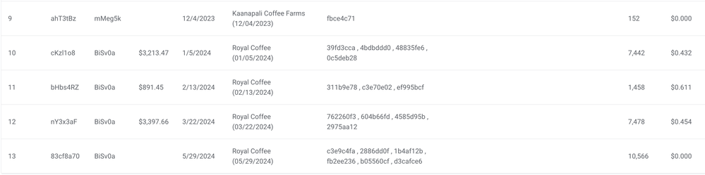

I am having issues with getting the correct result from this formula. It is returning the wrong max "Date Received" therefore the wrong "Shipment ID" etc. The interesting thing that I've noticed is that when I place the [_thisrow].[Origin 1] that I am looking for at the top of the [Related Coffee Inventory Purchaseds] list in its data table it then returns the correct max "Date Received" row. It makes me wonder if the formula is not looking past the first entry on the Related list.
Another issue is that the "Shipping Cost/Unit" that I am really after is being returned incorrectly regardless. The number it is returning is found nowhere on the Shipment Received Table.

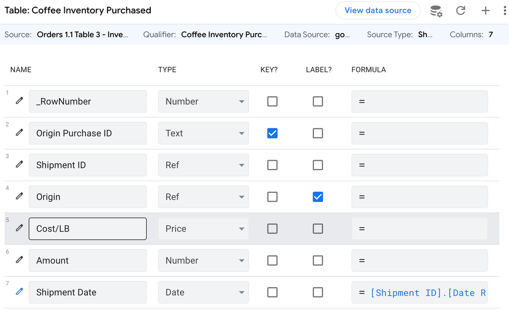

Table 1 = Roast Recipes
Table 2 = Shipment Received
Table 3 = Coffee Inventory Purchased

For some clarification - you want an expression on the โ€œRoast Recipesโ€ table get the [shipment id] with the most recent [date received] from the โ€œshipment receivedโ€ table. This [shipment id] must have a      [Shipping Cost/Unit]>0 and in its [origin] column a value that is found in [_thisRow] in the [origin 1]column on the โ€œRoast Recipiesโ€ table. You then want to use this [shipment id] to look up the [shipping cost/unit]
Am I understanding correctly?
The Lookup formula is actually returning the [Shipping Cost/Unit] from the Shipment Received table which is what I want. The Maxrow formula is telling the Lookup formula to return the row key of the latest [Date Received].
In addition there are two filters setup within the maxrow formula. The second, the easy one that you mentioned, is [Shipping Cost/Unit]>0. The first seems to be where the issue is. "in([_THISROW].[origin 1],[Related Coffee Inventory Purchaseds][Origin])". It's intention is to look for origin 1 in the Related Coffee Inventory data. Which it finds but not correctly.

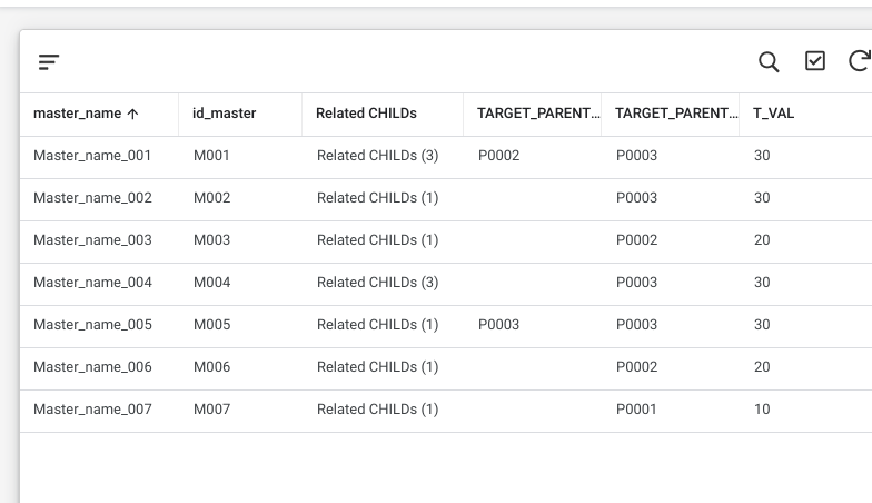

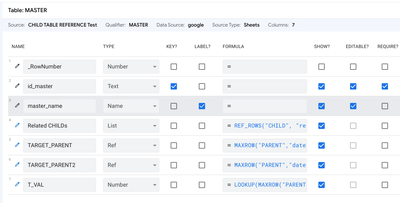

Here is (at least) one way to accomplish the result.
Three tables - MASTER, PARENT, CHILD
Table Definition - MASTER
//TARGET_PARENT
MAXROW("PARENT","date_col",IN([_THISROW],[Related CHILDs][ref_master]))
// TARGET_PARENT2
MAXROW("PARENT","date_col",IN([id_p],SELECT(CHILD[ref_p],[ref_master]=[_THISROW], TRUE)))
//T_VAL
LOOKUP(
 MAXROW("PARENT","date_col",IN([id_p],SELECT(CHILD[ref_p],[ref_master]=[_THISROW], TRUE))),
 "PARENT",
 "id_p",
 "val_to_retrieve"
Resulting View of MASTER
I hope Google looks at this and "fixes" it so the use of List Dereference is safe or at least makes it clear where it can be used safely. Perhaps I may be using it in the wrong way but if so, it is not obvious from any of the documentation I have read.
