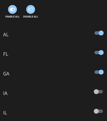

I'm stuck on how to do the 2nd lookup, using the value of the first lookup to build the value of the query. The structure "Range Filter" table is a two-letter state code for every state as the column name. For example: "Range Filter"[AL]='true'.
The reason for making states the column names was this was the only way known to use the quick-edit buttons in the UI to make it very simple. All the user sees in the view is: <State Code>: ON/OFF on a single row for each state.  Structuring the table in any other format prevented this clean/simple looking view.

The only reason why 'Range Filter' table was structured this way was to enable quick-edit buttons and make page which enables/disables each state as simple as possible, resulting in this view:
