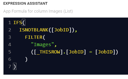

Okay. Next possibility: you have a non-virtual column that has an App formula expression. The App formula expression of a non-virtual column is reevaluated whenever the row is otherwise updated, such as when edited in a form or modified by an action. Th same is also true for any column that has an Initial Value expression and for which Reset on edit? is not OFF.
I have no Reset on Edit field applied in the table ‘Customers’, they are all unselected.
