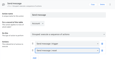

@lanlan, when I overlooked something as I developed an app today, I was reminded of a scenario that perhaps is related to yours. In case it's helpful, here's an explanation.
If your automation is triggered by a data change that is part of a grouped action, ensure that the grouped action does not include actions that change the row subsequent to the action that triggers the automation. That can create the type of conflict that Steve mentioned in an earlier reply. Following is an illustration.
In this grouped action, the "trigger" action changes a column's data in a manner that triggers an automation and the "reset" action clears that same column's value. In turn, the triggered automation populates some other columns in the same row. It had been a while since I last  created this type of action/automation pair, and I had forgotten that it's necessary to include the "reset" action in the automation rather than in the grouped action. Otherwise, the row updates from the grouped action's actions subsequent to the trigger can conflict with the row updates from the automation.
When my app didn't behave as I expected, I began troubleshooting by reviewing the row's edit history in the data source. That showed me that all my row updates were being saved, but in a sequential manner where some were overwriting others. If you haven't already tried, reviewing row- or cell-level edit history is a handy technique. If your data source is a Google Sheets spreadsheet, here's how to show a cell's edit history.
