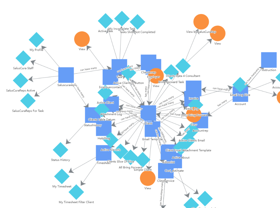

I have exported MS access to google docs and connected it to AppSheet, then I created the UX/Slices, etc. They had many tables with many large tables so modifying the structure was not in the plan, i had to do some though but appsheet was able to do everything i needed to replicate in MS Access. They as well had one-to-one and one-to-many table relationships.  I have gotten it all working, it took me several months as I had to learn AppSheet as well. Now we are adding new functionality that is not possible in ms access. AppSheet is not ideal (imho) for large forms except to use tabs or dashboards. Many related tables is impossible to see in the spec though which is not ideal. I had to be careful with the queries not slowing down the app with such large tables. We are pleased how quickly it opens and the inherent improved functionality 🙂 Definitely a BIG upgrade from MS access! 🙂
Home screen of App
Home screenHome screen
Data Spec 😞
data specdata spec
