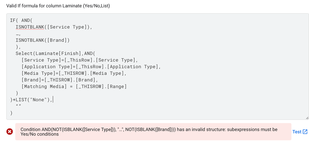

I think I've edited your code correctly but I get this error.
Replace the three dots … in the beginning by the rest of your columns, one line each, similar to service type and brand.
