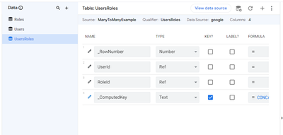

Many to many relation with a join table is a common use in every realational db.. I don't see many to many relations as "very use case specific", almost every business case need many to many relations, at least in my experience..
@WillowMobileSys wrote:
Namely, how does one signal to AppSheet that a join table is needed and which two tables should be joined?
Appsheet does not need to figure which tables, just let the user create the join table. Create the 2 reference fields and reference them to the other tables. Currently, if you do Users, Roles and a join table UsersRoles and reference that table to both Users and Roles, appsheet already let you to add in both Users and Roles the UserRole record. If you could just add it as enumlist or checkbox instead of "table related record".
When you configure this, like any normal db, appsheets already let you add the join records:
Its just that you need to add the rows one by one.
