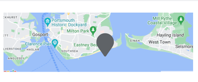

In a detail view, I have the Header Column set to column _osmlatlong, type = latlong.  On screen, the location pin is off...
If I switch the columns and put _osmlatlong in the column order, it displays differently - although, still slightly off.
I've double, double checked the latlong value (50.790219, -1.037997) and am comfortable it's correct... even though it displays a 3rd different way in Google maps
What's going on and can it be resolved so it displays consistently?

Support investigated and provided the following:
We understand that the pin is not pointing at the correct location due to its size.
Our team has checked your application and the pin size increases when the column is set as the header column.
We would like to provide you with a workaround for this issue.
We would suggest you create a format rule for the header column and adjust the size according to your requirement.
This resolved my issue.  FYI!

It seems to be something linked to the presentation/UI layer rather than the underlying data.
Please report this to support so devs could check the reason for this behavior.
