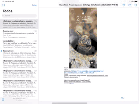

Solved it.
Google docs was forcing a link to be generated in the template, i had to eliminate this format in the first place, because the email generates another link, so this means a duplicate search URL (you can see this in my previous post screenshot).
Also I had to use SUBSTITUTE() to delete the extra spaces from the URL.

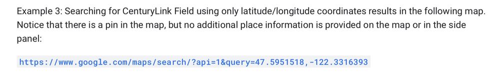

Did you check google map URL documentation?
I believe the things you want to achieve are well documented right there.
Thank you @tsuji_koichi I did that, and still I cant make it work.
The link in my email looks just like those in the Google Dev “Map URL” link you shared.
Heres what it looks like on the Google instructions:
This is what the workflow generated link looks like:
https://www.google.com/maps/search/?api=1&query=18.521850,-89.446720
I cant tell what´s wrong.
The only weird thing is that when I click on the workflow link, it seems if first goes to a website called mandrillapp?¿ which then redirects to google maps.
And when I copy the link from the workflow and paste it somewhere else I get this:
(https://mandrillapp.com/track/click/30578143/www.google.com?p=eyJzIjoiVGs2aHEtaFptVDhhaDJ3cWFWbHhYSl...)
It appears to me the parameter value for lat long, doing something wrong to you.
Your URL string does not include space after comma to split values of lat and long.
I simply add a space after comma, then it shoud work.
https://www.google.com/maps/search/?api=1&query=18.521850, -89.446720
You may need to add space when you construct the Google Map Webhook.

Tested it, the latlong is generated correctly.
Is this what you meant I should check?
Solved it.
Thanks @tsuji_koichi for your guidance.
