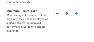

There is also a concept of Clustering in the Map View itself.  Do you have that on?
I have the google maps integration on , map pin limit to 400 and clustering is set to 0. the pin to my oun house is not showing up even. One thing I noticed is if I just use the address with no city, state or zip then they all show up but they are incorrect in different cities.

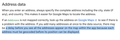

I seemed to recall some info about needing to geocode addresses and found this in the documentation:
How long has the "not showing" address been added to the app?  And did you add a lot of them all at once?   Maybe they just haven't been geocoded yet to allow them to show?
