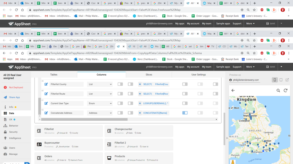

I have a table with outlets and the postcode for each one is defined as an address column type. A pin by the outlet takes the user to a map with a detail view to the left when in desktop browser mode. Some outlets work fine but some donโ€™t pin point the postcode location and the detail bar to the left doesnโ€™t appear. I canโ€™t work out why this might be. It is as if the postcode and oocation canโ€™t be found.
In have attached pics of one correct and incorrrect result.

I have attached pics showing the outlet โ€œslains castleโ€ in the list view and the map view from the same table (the first one is a slice of the table so I can specify which actions are accessed there).
When I search for โ€œslains Castleโ€ nothing comes up on the map.
Iโ€™ve Concatenated into a VC but that doesnโ€™t seem to work either anf only a handfull of locations are now recognised as in the pics below where you can see the full address and then when I click the pin it doesnโ€™t pinpoint the location. You can see how few that ae recognised now. There should be many more.
I can put the lat long in and use that but I need someone to adapt a google script to pull in the longitude and latitude from the address automatically when the address fields populate when a user adds a new outlet in appsheet.

I can use latlong to find the locations but appsheet doesnโ€™t create a system generated behaviour with a map pin that I can attatch to another column like postcode. I have to have another entry on the detail voew of each outlet with a mini map to click on. We already have lots of info in the detail so need a pin next to the poscode ideally to take the user to the pin pointed map.
Again, I still need a google script to find the latlong for new entries.
pic below
