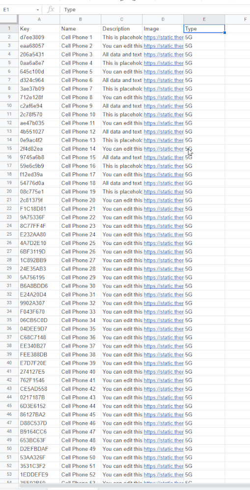

Iโ€™m testing a simple data update Automaiton like the one below with the run button selected, but Iโ€™m even more confused because the Prototype is able to update 11000 rows.

Thanks @Dan_Bahir, of course.
App id: Cellphone_sandbox-2214479
If you run All Clear Bot, all 11,000 records of Type column will be null.
If you run Update type to 5G Bot, all 11,000 records of Type column will be set to 5G.
If there is any other information you need, please let me know.
