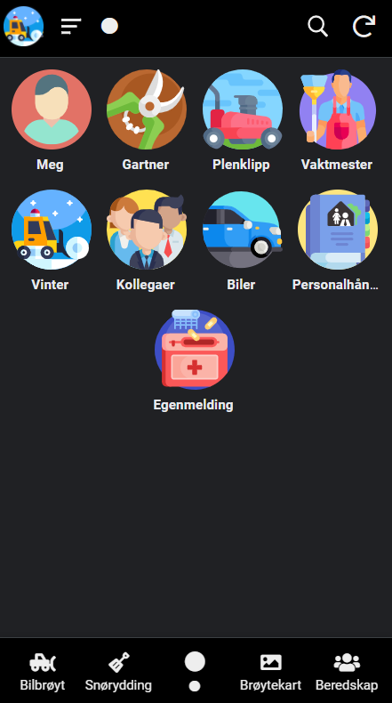

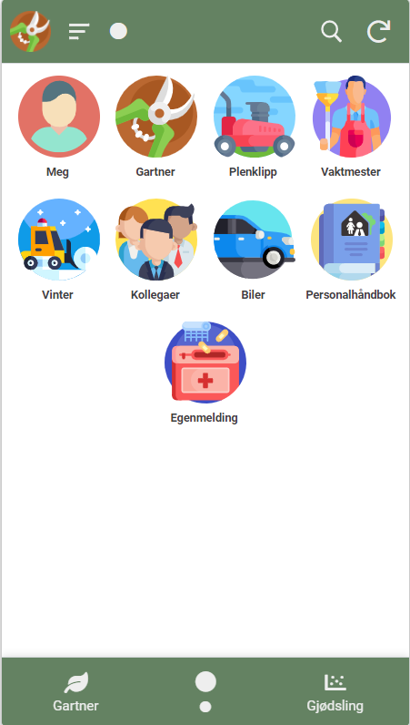

Hi, I’m splitting my app into multiple apps,
Right now, I need to add the main menu sheet to every new app, which is quite a hassle, and it steals loading time. (The middle button on the bottom bar)
Any ideas on how to make an intuitive link/button to a menu app in every app without doing this?
Out of the box thinking would also be very appreciated. I might be attacking this the wrong way.

What I do is make one spreadsheet just for menu.
Then for images and icon, I host images somewhere else, not within Appsheet. On the above mentioned speadsheet for menu, I place URL to reach out to such icon image with full URL.
From each app, I read this table. and make a gallery view.
Each app is refering to the same spreadsheet, and maintenance is easy. Just update spreadsheet and this change will be reflected to all the apps.
Adding full path url to the images will eliminate the works to add images to each app.
