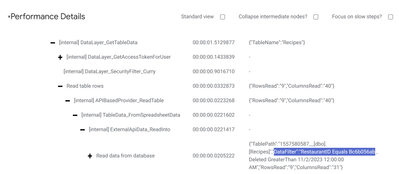

When using OR() as you have it, it's probably not pushed to BigQuery. At least it doesn't work with other databases like SQL, etc. Then it fetches all the data first to AppSheet's server before the security filter. If you have a huge amount of data, that could explain your behavior. When using IN(), databases don't undersand that expressions either, and that's why AppSheet needs to convert it before it's pushed to BigQuery. AppSheet converts it to a list of parameters.. and MS limits it to 2100.
So, if you remove the OR() and then use only one of your IN(), it should show you the correct result if the IN() brings less than 2100. Worth to test. You can check what is pushed from your app's Performance analyzer, It's called "DataFilter"
I don't think this would work as AppSheet doesn't do 'smart' transpiles using the BigQuery, connector. At least not as far as the documentation says. Is there a way to trace what queries get sent to the database provider so we can debug?
That's what you can check from the Analyzer. The sample that I took is using IN() with the SF. Though I'm using SQL (Azure), but it should work with BigQuery as far as I have understood.
I have used the Analyzer as you suggested, and this is what I saw when using my original Security Filter (with a three-clause OR statement):
Interestingly enough, the filter didn't appear at all.
This was the log for the same table when I used a single field in the Security Filter:
This was the filter for the second test, a single IN() command:
The values I used in the filter should 100% return some rows (based on BigQuery tests), but in both cases, no data was displayed on AppSheet.
I feel that AppSheet only gets a maximum of 100k rows, no matter what.
So.. the single IN() is pushed to BigQuery as you can see it from the DataFilter, but it's probably not finding the row because you have more than 100k rows to read. Let me check if there is such a limit.
Hello @AleksiAlkio! I have seen this before as well. I thought that the way I was using the security filters should allow me to filter through the entire data (i.e., more than 100k rows).
As per your test, it sounds it doesn't go through all rows, just the first 100k rows.. probably.
I encounter the same problem, although it is specified that the filter applies before retrieving the 100,000 rows.
