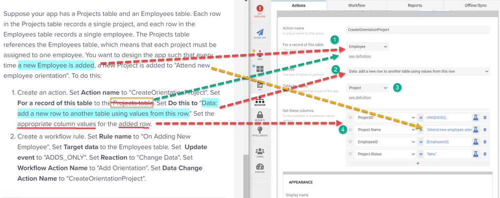

Iยดm reading this article: https://help.appsheet.com/en/articles/1363923-changing-data-from-a-workflow-rule-or-scheduled-report
And maybe Iยดm misunderstanding something or maybe thereยดs an error in the example.
Create an action. Set Action name to โUpdate Employee Statusโ. Set For a record of this table to the Employees table. Set Do this to โData: set the values of some column in this rowโ. Configure the column and value to set the employeeโs status to โAssignedโ.
Create an action. Set Action name to โGet Employees to Updateโ. Set For a record of this table to the Employees table. Set Do this to โData: execute an action on a set of rowsโ. Set Referenced table to the Employees table. Set Referenced Action to โUpdate Employee Statusโ. Set Referenced Rows to an expression that returns a list of row keys from the Employees table. The row keys will be used by AppSheet to identify the employees to be updated. For example, to select the employee that has been assigned to the current project, use the expression:
SELECT(Employees[Employee ID], [Employee ID] = [_THISROW].[Employee ID])

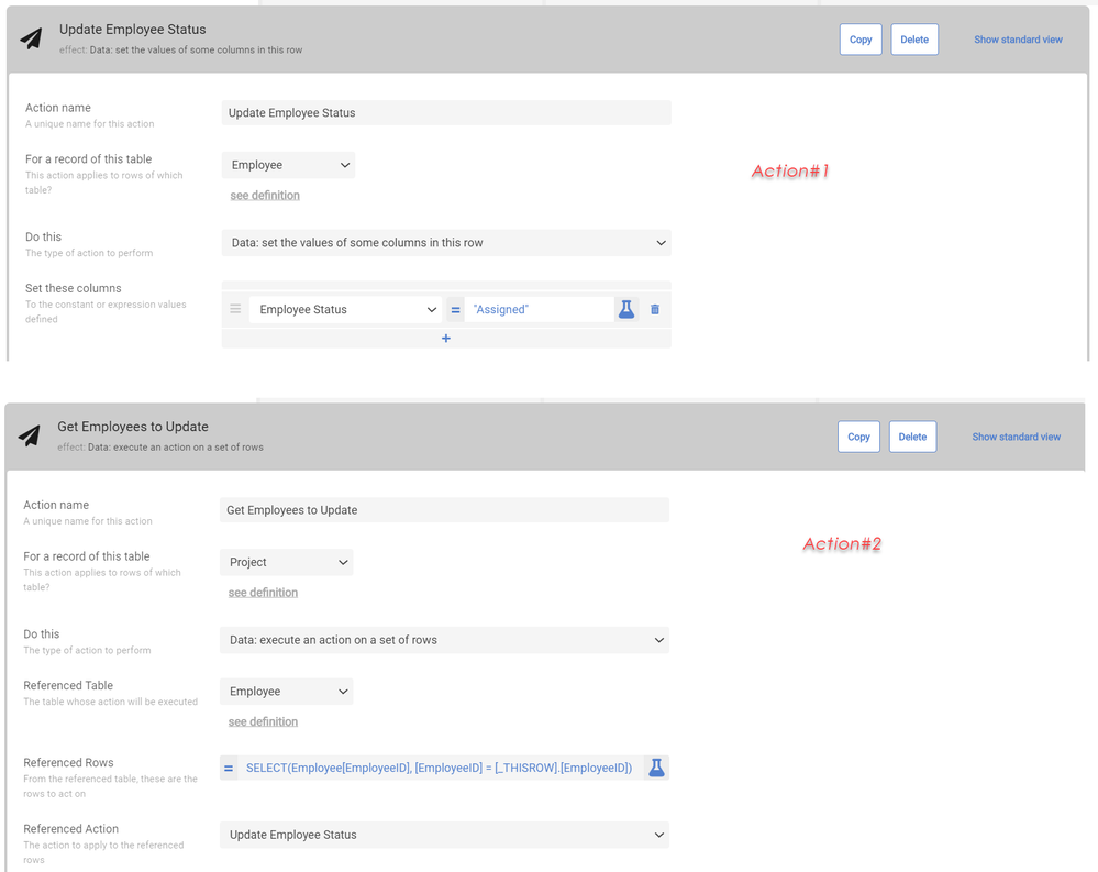

It should work if action#2 Set For a record of this table Employees Table is changed to Set For a record of this table Project Table.
Thanks but no. If the change is set to the Project Table, then the Action 1 wonยดt appear in the โReferenced Actionโ drop down.
And if I change the table on the Action 1, then Iยดm not making a change in the Employees table.
Iยดd created a project just with the example data and itยดs not working.
This is My Action set-up:
And this is the Workflow:
