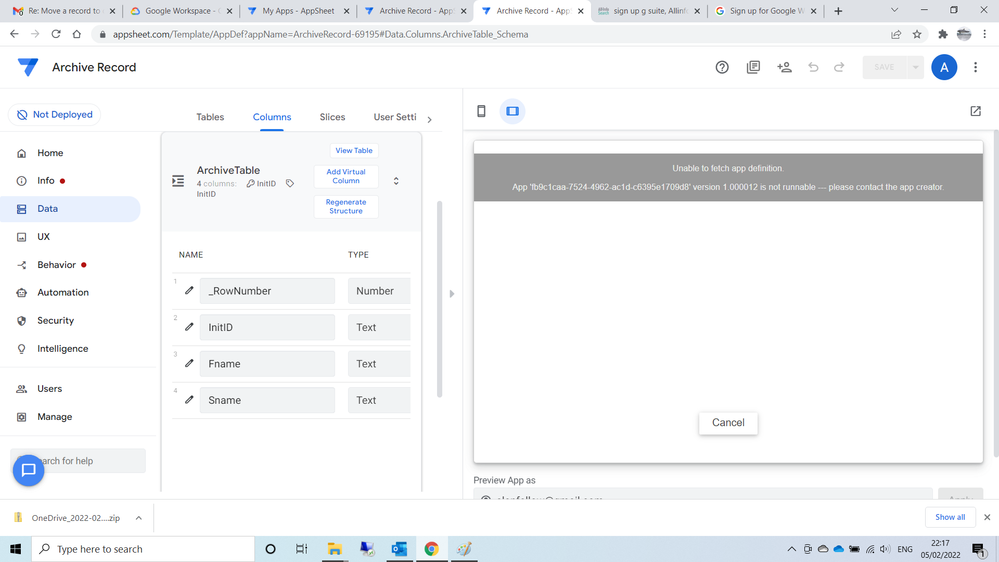

Here are a few images I am just trying with small sheets to see if i can get it working.
Looks like you are assigning a value to ArchID which you do not have in your ArchiveTable.
Choose InitID instead.
Also the expressions "text val..." give you literally "text val..." text. You should use column expressions such as [ArchID],[Fname],[Sname].

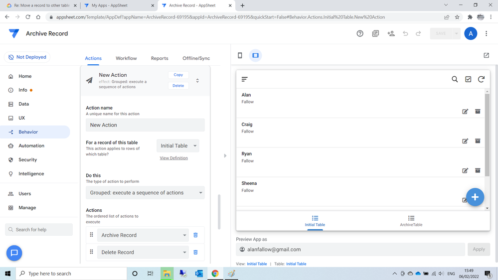

Hi I have setup Grouped copy and delete this row.  Copies but doesnt delete.  Added System generated delete but only copies but doesnt delete. 😫  So close..
You'll need to show us what you are doing for Delete.
Delete is the easiest and simplest action available.  It is very hard to get it wrong.
Make sure your table is set up to allow delete....
Yes!  Very good thinking!
Both tables have delete insert updates ticked.  Here are the 3 actions,
Thanks again.
Ok, so you have confirmed Delete is enabled for the table.
Next check the Behavior of your "Delete Record" action.  Make sure it is set to blank, true or some expression that is evaluating to true.
The action is not shown in your Deck view, so I assume you are accessing the action on the Detail view after selecting a row ?
Hi yes the behaviour is set to true.  Not sure what you mean about deck view and details view but everything looks ok.  Only thing I was thinking.  How does the delete action know what row to delete.  Overthinking.
Here is settings for delete
Wait a min think i have sussed it.
I was clicking the copy icon when i should have had that hidden to and only have had the grouped icon which executed both actions.  Thanks again for all your time.  Very much appreciated.  I had a mess about with powerapps and this was virtualy impossible to do without a degree in science hence I ditched that. 😆
