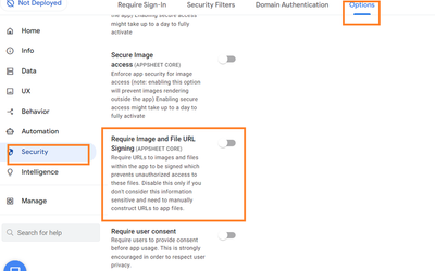

Please ensure you set the following setting to off or images may not render in the enum. of course please evaluate your app's security needs while making this setting.
Hi @Suvrutt_Gurjar !
Btw, I have never had the need to turn off that option if the path to the image is relative to the worksheet, similar to how images or file uploaded through the app are saved

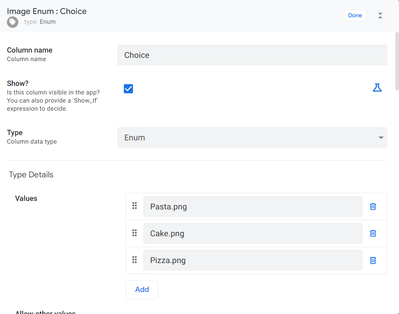

I have one question , how can i add images (path) to my options for enum / enum list . I do not want to add simple text .
As mentioned,  please add images in the root folder of the app. So if you have an enum option as check.png, then an image "check.png" needs to be available in the app's root folder.
Ok will try this for sure , Thanks
Hi @rahuldash171 ,
So it will be something like below.
In the app's form view, enum will look like this
The enum button settings are as below

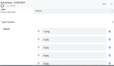

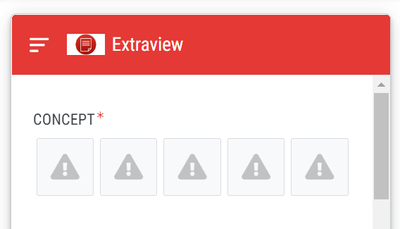

I tried the steps mentioned by you . But in my app image icons are coming as text although i have uploaded the images in app's root folder .Please view the attached screenshots . Please suggest if i am missing something .
Could you check what is the base type of the enum please?
Image only
I have disabled this setting also .
Then it could be to do with image sharing permissions. Also hope the backend sheet is in the same folders as the images.

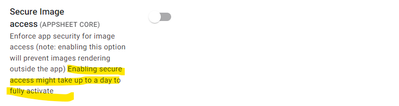

Or it could be the following. Please wait for some time. Yesterday for me also the images appeared after sometime.
However would appreciate if you post finally it worked for you or not. This long thread then will help someone with similar requirement. Thank you.
