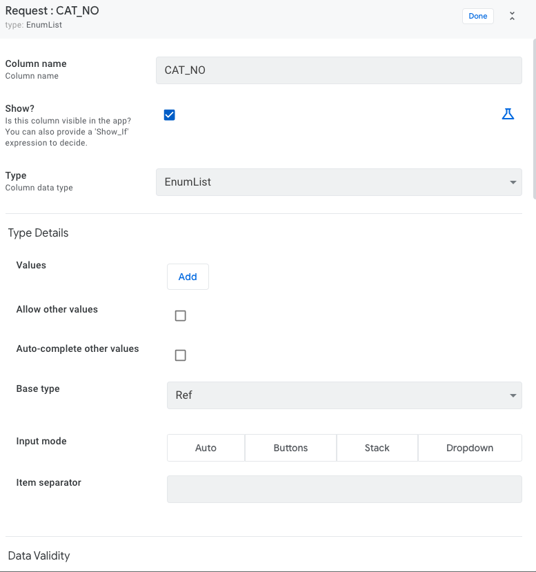

You have to save the app after selecting EnumList and setting the type to Ref, then you can set the base type table.
First set the Type to EnumList, then set Base Type to Ref. Then SAVE!
It will give an error because you couldn’t set the table before but now you can. See Referenced Table Name. It’s been like this as long as I’ve been using AppSheet. I don’t understand why they make it a two step process.

I’ve had a look through this but was unable to find the exact answer I was after, I found a sample app below, which does what I need, allows for an Enumlist where multiple entries from a referenced table can be selected by using a EnumList Type, Base type set to Ref and a section called Base Type Details where the referenced table is selected. However, I was unable to replicate this in my app, the Base Type Details is not visible in my view.
