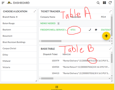

It seems to work, however every row in Table B is green, which I OLNY want the row that contains it to be green:

Are you sure the literal text 4751 doesn't occur anywhere in [item list] of the second row of Table B?
I checked it, but there are like 7 rows and ALL are green.  I am pretty sure NONE conatin that.  It has to be exactly "4751" in that order, right?

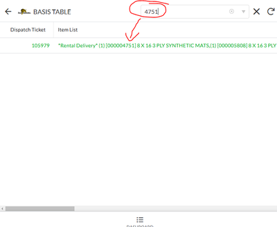

If I expand that Table/view and search for "4751" - only ONE row shows:
Now when searching:

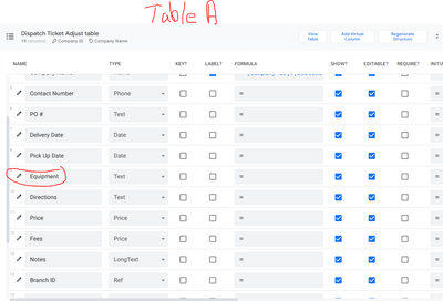

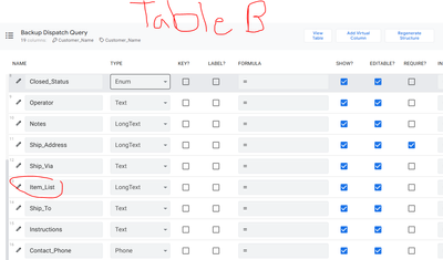

Please post screenshots configurations of the equipment column of Table A and the item list column of Table B.
Table A, showing [equipment]:
Table B:

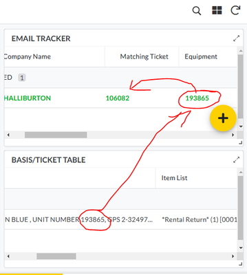

   So I added a column to show the matching ticket from Table B (if there is one).  It works BUT only works if you have EXATLY the data string.
For example,
 If [Equipment] contains the data - "193865" - IT WORKS:

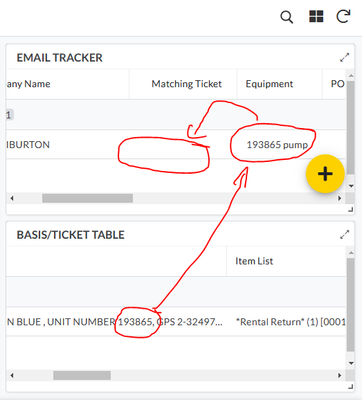

However, you you have anything more added in [Equipment] - It now doesn't work:
How can I fix this?
