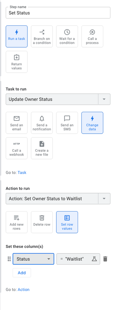

So, Iโ€™m trying to follow this. I created a process called Owners: Set Status, as can be see on the attached screen shot. It runs a task to change data, but then needs an Action to run. How can I pass in the value of the current petโ€™s Status into this Action to have it set appropriately? Or, do I need to do a separate one for every Status I have? As you can see in the second screen shot, if I choose an action I created for the Owners table to set the status to โ€œWaitlistโ€ which is a specific status (I have 7 different statuses) it only allows me to access things from the Owners table. Iโ€™d like to pass in the value of [Pet Status] from the Pet record that triggered this.
So Iโ€™ve created a Bot with an event, process and action as shown above to just set the Owner status to โ€œWaitlistโ€ once the Pet Status is sent to โ€œWaitlistโ€ and I get this error:
Error encountered in step with name [Set Owner Status to Waitlist]: Could not find row with key: in table:Owners.
What am I doing wrong?
