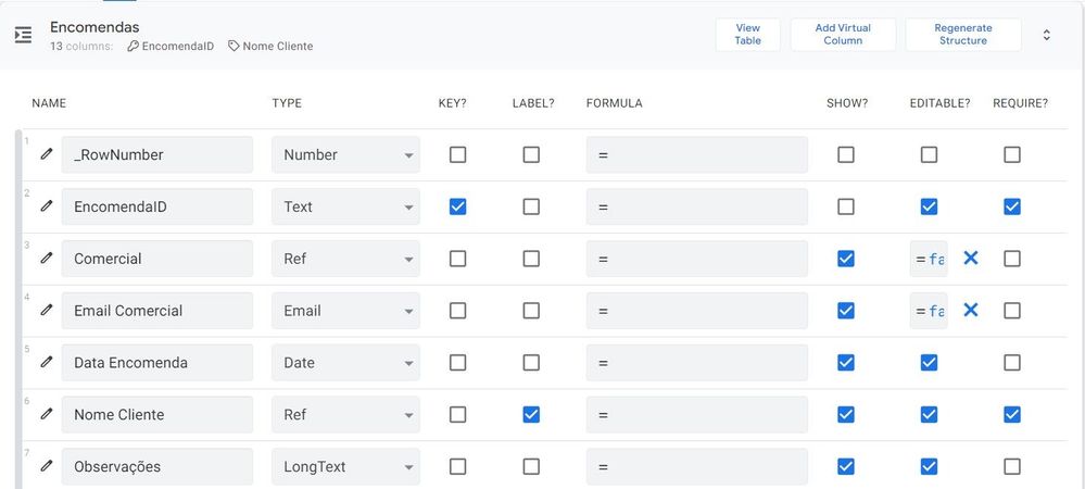

But I'm not figure out how to fix the names on the Encomendas table:
I believe I miss something. ๐Ÿคจ

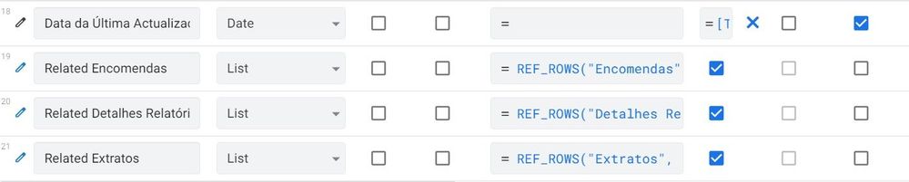

Do you mean show you the column config like this:

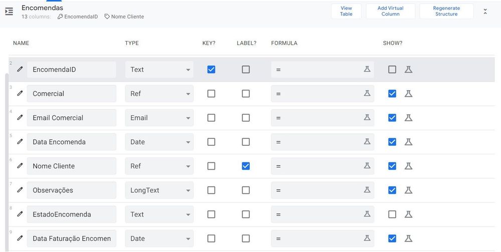

I checked the slice and it is correct. And my "Encomendas" is well configured:
