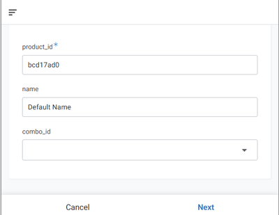

Need to pass default data from external link
I would like a regular URL to be able to call open a record in my app, and pre-populated a field.  This is what I tried but no luck.  I also tried with the %22 being double quote.
https://www.appsheet.com/start/32dc2d71-f30e-447c-aab3-019e468d51c2#table=My%20ROI%20Calculator%20In...}
