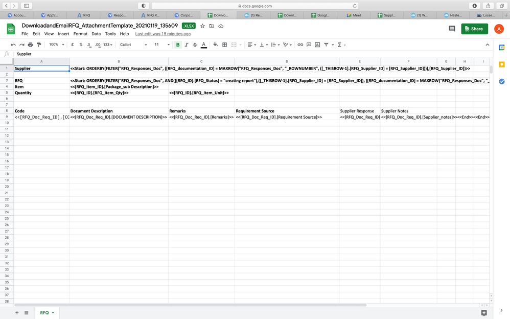

I have been breaking my head to get this working and not able to solve it. It will be a great help if somebody can take a look and let me know what I am missing here.
<<Start: ORDERBY(FILTER("RFQ_Responses_Doc", ([RFQ_documentation_ID] = MAXROW("RFQ_Responses_Doc", "_ROWNUMBER", ([_THISROW-1].[RFQ_Supplier_ID] = [RFQ_Supplier_ID]))),[RFQ_Supplier_ID])>>
<<Start: ORDERBY(FILTER("RFQ_Responses_Doc", AND(([RFQ_ID].[RFQ_Status] = "creating report"),([_THISROW-1].[RFQ_Supplier_ID] = [RFQ_Supplier_ID]), ([RFQ_documentation_ID] = MAXROW("RFQ_Responses_Doc", "_ROWNUMBER", AND(([_THISROW-1].[RFQ_ID=[RFQ_ID]), ([_THISROW-1].[RFQ_Supplier_ID] = [RFQ_Supplier_ID])))))),[RFQ_ID])>>
<<[RFQ_Item_ID].[Package_sub Description]>>
<<[RFQ_ID].[RFQ_Item_Qty]>>  <<[RFQ_ID].[RFQ_Item_Unit]>>
<<[RFQ_Doc_Req_ID].[CODE]>>	<<[RFQ_Doc_Req_ID].[DOCUMENT DESCRIPTION]>>	<<[RFQ_Doc_Req_ID].[Remarks]>>	<<[RFQ_Doc_Req_ID].[Requirement Source]>>	<<[RFQ_Doc_Req_ID].[Supplier_Response]>>	<<[RFQ_Doc_Req_ID].[Supplier_notes]>>
<<End>><<End>>

Please also include a screenshot of the template xlsx file itself.
thanks, I added the screen shot

โ€œErrorsโ€: โ€œError: Workflow rule โ€˜DownloadandEmailRFQโ€™ action โ€˜Emailโ€™ Attachment template. Found 2 unmatched โ€˜Startโ€™, 2 unmatched โ€˜End. They are: Cell[1,2]: <<Start: ORDERBY(FILTER(โ€œRFQ_Responses_Docโ€, ([RFQ_documentation_ID] = MAXROW(โ€œRFQ_Responses_Docโ€, โ€œ_ROWNUMBERโ€, ([_THISROW-1].[RFQ_Supplier_ID] = [RFQ_Supplier_ID]))),[RFQ_Supplier_ID])>>โ€™, โ€˜Cell[3,2]: <<Start: ORDERBY(FILTER(โ€œRFQ_Responses_Docโ€, AND(([RFQ_ID].[RFQ_Status] = โ€œcreating reportโ€),([_THISROW-1].[RFQ_Supplier_ID] = [RFQ_Supplier_ID]), ([RFQ_documentation_ID] = MAXROW(โ€œRFQ_Responses_Docโ€, โ€œ_ROWNUMBERโ€, AND(([_THISROW-1].[RFQ_ID] = [RFQ_ID]), ([_THISROW-1].[RFQ_Supplier_ID] = [RFQ_Supplier_ID])))))),[RFQ_ID])>>โ€™, โ€˜Cell[9,6]: <<[RFQ_Doc_Req_ID].[Supplier_notes]>><>โ€™, 'Cell[11,1]: <>โ€,

Ah good question, its running on RFQ table which is the master with Supplier and each Supplier having RFQ_Response_doc table. I will try and make some changes to the template by moving supplier start lower

This is the screen shot of the UX showing the data. I am trying to create a XLS for RFQ with responses received from each supplier.
So it looks like you have a REF_ROWS() virtual column for โ€œSupplier Response Requirementsโ€ ?
You can simply do <<START: [Supplier Response Requirements] >>

Beyond that simplification of the START, I think youโ€™re trying to get more out of an XLSX template than is possible, actually.
See here:
Particularly:
START expressions canโ€™t span across multiple rows in an XLSX template I donโ€™t believe. You can do so with a CSV template if you need the ability to quickly load it into a spreadsheet, or you can build a template in a Google Doc to convert to a PDF to get that kind of multi-row table setup.
Hi Marc, you are right it worked with PDF but not with XLSX. Thanks
