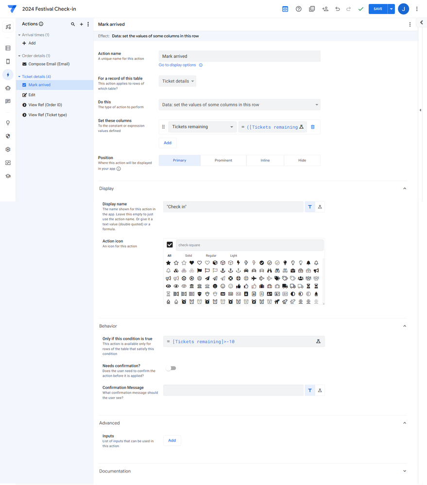

I've set that number to decrease by one each time the Check in action is run (the tick icon), so functionally, that's working*, but the action icon is a bit small.  I'd also like to add a ticket image (these are colour and shape coded for each type of ticket, which would make it more visually appealing and also make the ticket type a bit more obvious.
It's a 3 day festival, and people can buy tickets for the full weekend, just Saturday, just Sunday or just Monday, so we need to make sure we're seeing tickets for the right day.
*I've also discovered a much bigger problem.  My action is acting on the wrong row in the ticket details sheet.  It doesn't matter which action icon I tap on, it always decreases the number of tickets for the first ticket type in the order.  So in the example above, I can't ever check in the Adult ticket.
I've videoed it happening, but can't upload videos here.
