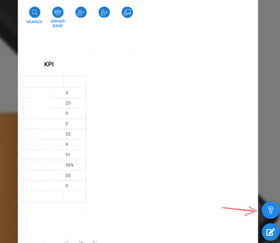

I have a lot of different sections in my app and I want to collect all help content in one table and make dynamic call of the relevant content via Help button from any section. Menu organized on detail view pages with submenu action buttons (display prominently). Help button is in bottom right corner (display overlay).

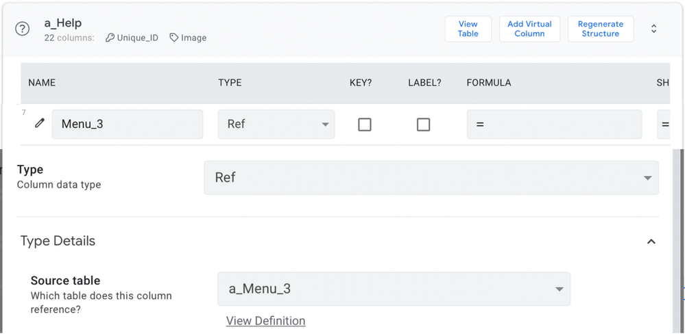

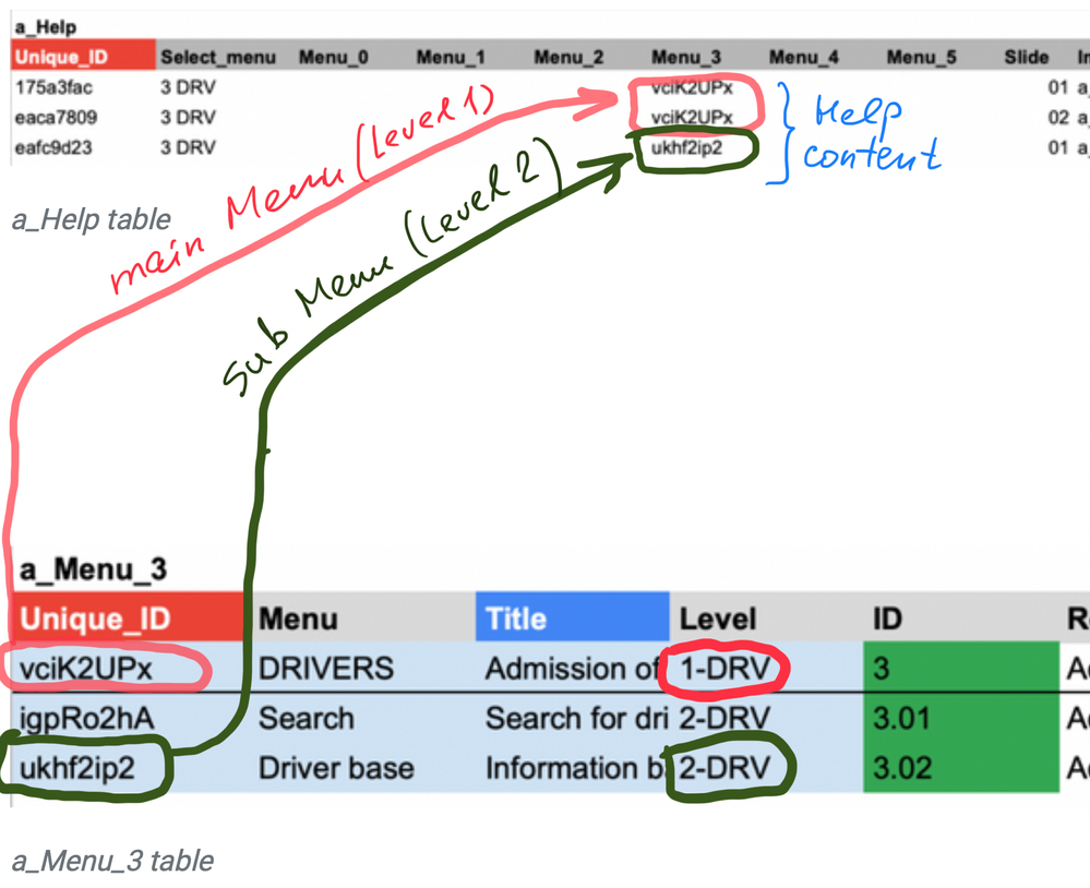

  • a_Help - a table, that contain the content for Onboarding View and REF-links to relevant record of menu.
  • a_Menu_3 - a table with names of any levels of submenu, titles and other information.

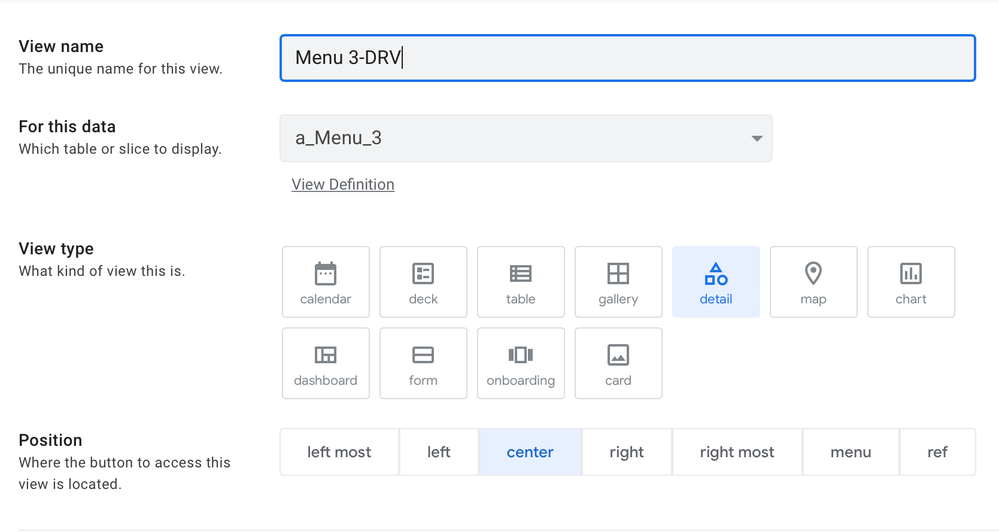

  • Menu 3-DRV - a view of Detail type as main page of section menu button collection.

  • Help_Menu_3 - a Behavior action witch display the Help button on each level of Menu and dynamically redirect to relevant help content.

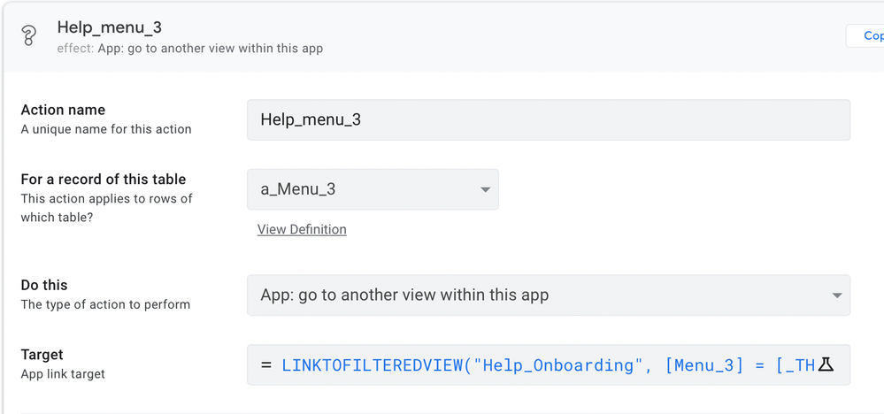

 Help_Menu_3 (Behavior Action)
 Target
LINKTOFILTEREDVIEW("Help_Onboarding", [Menu_3] = [_THISROW].[Unique_ID])
Behavior
ISNOTBLANK(
   ANY(
      SELECT(a_Help[Menu_3], [Menu_3]=[_THISROW].[Unique_ID])

My idea is that a set of hint records (help slides) is linked to one of menu level. And when the user is at a certain menu level, he should only see (in Onboarding view) the set of slides that is assigned to this menu level. I use one Overlay Help button (Behavior action) for all levels of menu.
My problem is that when I'm in the main menu, I see slides of both the main menu and slides of the submenu. The same thing happens at the second level of the menu. That is, there is no filtering. I think this approach would work with the usual transitions between different pages. But since the organization of such menu (using the Detail view base page and Behavior Actions buttons) is based on a Detail view of the one base page for main menu and all submenus, the problem may be here and I would like to understand how it can be solved.
I do understand the concept.  Your detail view show a row from a_Menu_3 which has a Unique_ID value associated with it.  When tapping the Help button, the expression should filter the a-Help table by Unique_ID value in the detail view row and show, in your use case, only 2 out of the 3 rows.  But you are seeing all rows.

The a_Help table has a [Menu_3] column that refers to the a_Menu_3 table (REF link). Accordingly, the a_Menu_3 table has the [Related a_Helps] column, which correctly displays only those hints that correspond to the current page.
REF_ROWS("a_Help", "Menu_3")
The main question is how to convert the REF_ROWS type to a type or list that can be used in the Onboarding view.

Unfortunately,  Onboarding views will not honor a filtered list of rows.  They always show ALL rows in the datasource attached to the view.
What you CAN do is create a Slice to segregate the rows from your source table.  You will then need to create a view for each Slice and attach respective Slice.   Once you have this established then all you need to do is use LINKTOVIEW() to see the desired Onboarding rows.
