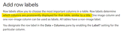

You need to select the correct column with the Label Property in the people table.
For reference:
Add row labels

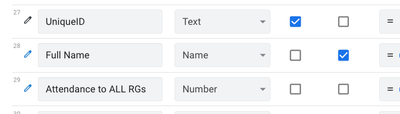

Thanks @Aurelien
I believe I do have the correct label, except that it is a virtual column (calculated column) does that matter?
No, it should be OK.
But do you know why this expression still doesn't work? Sorry to bother you.
Did you set the column type as Ref, source table: "your table of users" ?
If not, please do.
If yes, can you please share screnshots, from your app editor, of:
- the table where you use this expression, and the column settings
Thank you.
The column type wasn't 'Ref' - great pick, thanks to you. So I changed that column to Ref.
But now, the other columns that use the Ref column type are throwing errors. For example, the column name EnumList is the 'Full Name' dropdown column.
Number Attendees = Counts the number in the EnumList
Who Absent = uses the EnumList to find out who in the entire list did not attend.
Hi @Dan_Velus
The idea is the same for these expressions you highlight. If you have list or enumlist columns that are based on [FullName], you may need to get rid of these and instead use the Ref.
About the screenshot you provide, on your [EnumList] column, I suggest changing type with EnumList type, and Base type Ref.
Something like that, for example:
