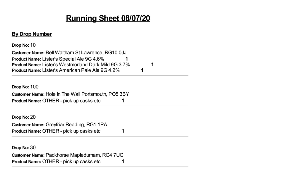

I have a report that sends an email and orders driver delivery drops by number. Each delivery is assigned a number from 1 onwards.
The order comes out fine until it gets to number “10” which it places after “1” rather than “9”. I have changed the order numbers to 10, 20 , 30 etc and still the same result. 100 comes after 10.7
Expression is
<<Start:Orderby(Running Sheet 24[Outlet No],[Running Sheet Report Calc],FALSE)>>
Any ideas why? Pic attached
thanks
Phil

Wrap the SELECT() expression in ANY(), then make sure the column type is Number.
Is [Running Sheet Report Calc] set to a column type of number?
Hi Simon, Yes it’s set to Number
Would SORT() work better? I couldn’t work out how to write the expression.
thanks
Phil
Hi, Sorry
It is set to list. It is a virtual column with this expression
SELECT(Orders[User Stop],AND([Outlet No]=[_THISROW].[Outlet No],IN([Delivery Date],Running Sheet 2[Delivery Date]),OR([Order Status]=“Open”,[Order Status]=“Exported To Xero”,[Order Status]=“Open (Unarchived)”)),IN([Route],Running Sheet 2[Route]))
If I change it to number - how do I cange the expression to get the corrrect result as in number from the expression above
thanks
Phil
That worked
thank you
phil
