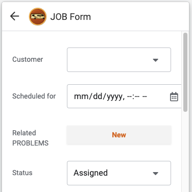

In the form below (JOB Form), the first entry looks up the customer from our table of customers. When I add a new customer, as expected, it goes to the bottom of the customer table but this means that the table order of customers is not alphabetical, but rather by entry date. How can I sort the customer list so that it appears alphabetically in the JOB form, accommodating new names as added? Note that the list of customers is actually a computer-generated field concatenating the first and last names which are entered separately if this matters. I'd like to alpha by last then first. Thanks for guidance.
SCREENSHOT OF FORM

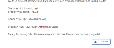

I've tried different permutations, but keep getting an error code "Orderby has invalid inputs"
The three I think are closest:
ORDERBY([CID],[CID].[CLast])
ORDERBY([CID],CUSTOMER[CLast])
ORDERBY(CUSTOMER[CID],CUSTOMER[CLast])
Clearly I'm having difficulty referencing across tables. I'm so sorry, but can you guide?
Thank you @Marc_Dillon - really appreciate the kind guidance. I read through your tip and it helped to clarify the syntax.
For those who might stumble upon this, the final expression that got me over the finish line was:
ORDERBY(CUSTOMER[CID],[CLast],FALSE,[CFirst])
