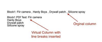

I found my example but it was using EnumList of text comments rather than a Ref.  But i was able to build this similar function in a test app.
Test Template Output (not pretty but one item per line)
I created a Virtual Column using the EnumList column as follows:
Virtual Column Definition
Full expression in Virtual Column
So this worked brilliantly. Because my text had commas in it, I had to adjust the substitution search by ensuring that all of my statements end in a period, then I search for ". , " and replace that.
Thank you so much for your help on this one, I've been trying to solve this detail for a while and can now indulge my obsessive need to format things nicely!
