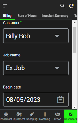

I am on the struggle bus with trying to figure out this pdf automation. I have a dashboard that filters a customer, job, and start and end dates. I want their data to be exported into a pdf. I don't know how to make it automate that because I am not making a new row. It is changing all the time and I want it to take the information currently on the screen and make a pdf. Preferably with an action.
What am I missing?

I am just changing the values in this filtered dashboard and it shows the customers data for that time frame. I want to be able to export this as a pdf to send to that customer. So I created an action that set the time now that fires the bot.
