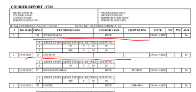

                         I have trouble in PDF template structure.
I have very close lines in the table as shown in the below screenshot.
but after generating PDF I get these extra space how to avoid it.
I have done my known measures like reducing line spacing , cell padding, middle alignment etc to reduce space even though it generates like this.
RED lines denotes extra space.
screenshot after inserting formula to columns

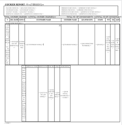

Issue 2.
Column space rearrange or not fixed in output.
here is the link of the template with commentor permission.

Hi bro,
already I have tried whatever you have said like cell padding etc. But still I am getting extra space. I have attached a sample file in the link kindly check and describe your ideas and corrections please.
Problem 2 :
I have set the column sizes and position / placement as needed in the template but after PDF generation, in the generated file i am getting different sizes position/placement.
Let's say in template << [state]>>
This will not be straight to the header. And position of output will be slightly deviated (this you can find in the images in the post.)
I responded in the doc but for others to learn from this, I am replicating it here.
This is comment most refers to the template table inside of the START/END expression:
The issue you are facing is that you have these inner tables inside of cells of
another table.  Each level requires its own padding and before/after spacing.
Remove the outer document table.
Instead place the row with customer Name and State as its own table - a single row
table w/ no headers.  Cut/Paste should work.
Then insert a separate 2 row table for the Article data just as you have it now.
Again, cust/paste should work.
As for State column not aligning with State header, that is an issue with the headers
being in a separate table.  To get the alignment as close as possible, set a hard coded
column width in both the header template table and the data template table.
