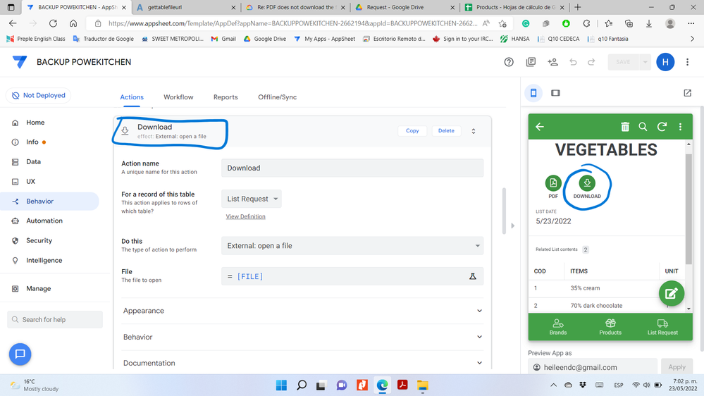

By the way, it looks like your Download button is simply opening the PDF file which I assume your PDF button is doing as well.  Why have two buttons doing the same thing?  The actual download option is embedded in the PDF viewer.  You only need the ability to open the PDF then a user can choose to download if they wish.

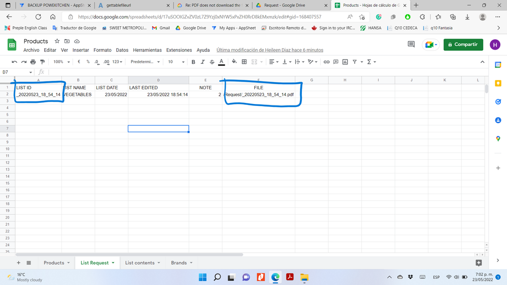

Hi Steve, thanks to the comments of WillowMobileSys and Joseph_Seddik, I am doing that, but the problem I am facing is that when attempting to download the file, I am getting the older version of the file and NOT the new version.
