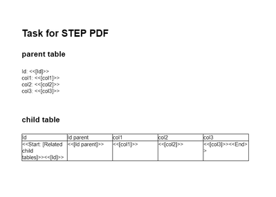

my friend, My template is this... automatically generated. When I create a form with this configuration, only the parent table is populated. the rest is blank.
this is the example of what i mean
Remove the "s" in id column.
<<Start: [Related child table]>><<[id]>>
Other than that there's no problem with your template, unless you remove as an outline the child table
Can you understand ??

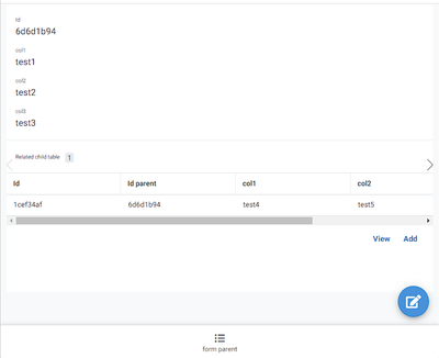

Can you show me your detail view?
look
From your detail view, where did you place your action? You place it as "Display in Primary"?
This is my detail view ๐Ÿ‘‡

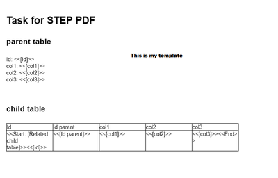

This is my template ๐Ÿ‘‡

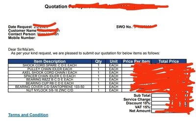

This is the result ๐Ÿ‘‡
Do not change something that may cause the outline of your template will get affected

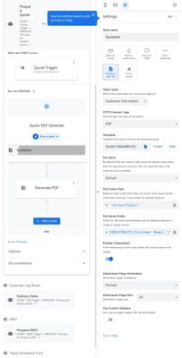

can you show me the screenshot of your atomation
event and step
My item description is not the key. I have "key column" that I hide and it's related to the parent table.
My automations ๐Ÿ‘‡

My automation
Events
Process
