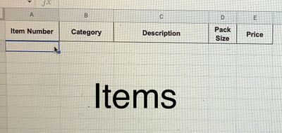

So I want to receive an item.
After the Item is received, I need it to autofill these (I will fill in the price)…
I have used ref to link the item number.
I try Any(Select(Receiving[Category],[_Thisrow].[Item Number]=[Item Number]))
I use that in my deployed app to get pack size and price on the sales order.
I need the items to be a enum list, so I can select multiple items to add to my “sales cart”.
When an account is selected, it will attach the sale to the account selected.
The account details will have all of the purchases. But I can’t figure out how to get a total balance. I want to add a payment option to the balance.
Then I want it all summed up in Inventory.
