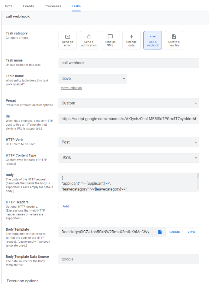

Can you show a screenshot of the entire Task definition?
No problem, here you go:
Can you actually have both a Body and a Body Template?
I don’t think so - the template takes precedence, I believe. The UX should prevent the user from being able to specify both but it doesn’t.
I tried with only the body and the outcome is still the same.
