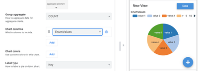

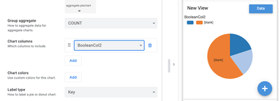

Pie chart value labels for Yes/No field missing?
For pie charts based on an enum field, the value key associated with each chart section appears in the legend, in the tooltip that displays when hovering over the section, and if selected as the Label type property also on the chart section itself.
However, for pie charts based on yes/no fields the value key doesn't display anywhere--regardless of whether custom values are entered for the column's Yes/No display values property. The chart appropriately creates a chart section for each value, but there's no indication of which section corresponds to true vs. false. It's extra confusing that only the false section's color appears in the legend, which doesn't even include the color for the true section. If there are blank values, that is labeled and also assigned its own color, which appears in the legend.
Is there a setting somewhere that governs this? Is this a bug?

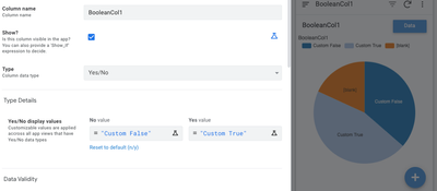

Indeed it's now working.
Column does not have custom values: Chart labels are Y/N
Column has custom values: Chart labels are the custom values:

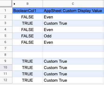

FWIW, here's the behavior when the custom value varies across rows.
Custom false expression:
IF(MOD([_RowNumber], 2) = 0, "Even", "Odd")
Data:
It's unclear how AppSheet determines which of multiple custom false values to use as the chart label. Regardless, as we've discussed in this thread, that's an edge case with no self-evident way that it should be handled within current AppSheet functionality and is perhaps consistent with analogous scenarios like column header labels in table views.

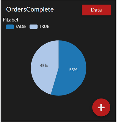

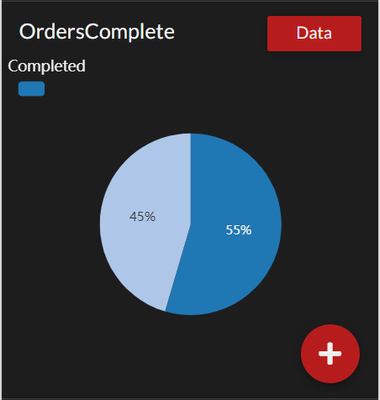

Hi @dbaum Your observation is correct. This seems to be a bug.
The below chart shows a column [Completed] with true / false values does not have labels.
One workaround is as follows.
Please create a VC called say [PiWithLabel] with an expression something like
IF([BooleanCol1], "TRUE", "FALSE")
Or to show blanks as well :
IFS([BooleanCol2], "TRUE", NOT([BooleanCol2]) , "FALSE", ISBLANK([BooleanCol2]), "BLANK")
Then if you base the chart on this [PiWithLabel] column, it will look like below
Yep, that's a logical workaround.
For reference by anyone interested: If you don't need more than just "Y" and "N", your shadow column for the workaround can just use the TEXT() function:
TEXT([BooleanCol1])

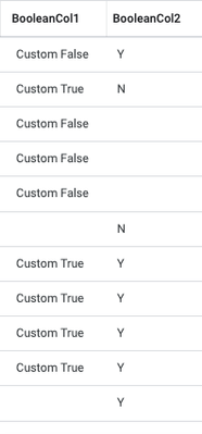

Here are screenshots to illustrate these test cases using the following Yes/No columns:
  • BooleanCol1 includes custom Yes/No display values
  • BooleanCol2 does not include custom Yes/No display values
Table view showing values for both columns as expected
Chart view showing values as expected for test case A
Chart view showing unexpected values for test case B
Data:
