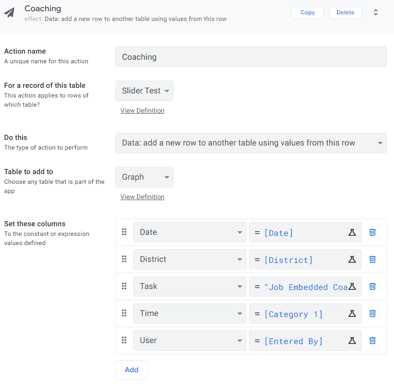

I wanted to take a moment to share how I worked this out once Marc pointed me in the right direction. I’m sure there is a fancier way to do it, but I was able to make it work they way I wanted with existing tools and my (very) limited skillset!
First, I made an action for each of the 5 time category columns that would extract the needed data and put it in it’s own row on the helper sheet using Data: add a new row to another table using values from this row.
Then I made a new action: Grouped: Execute a sequence of actions and added the 5 time category actions.
Finally, I added the new Grouped action to trigger when the slider form is submitted.
My current solution is to use slices from the helper table based on USEREMAIL to show each person’s individual graph and it works perfectly.
