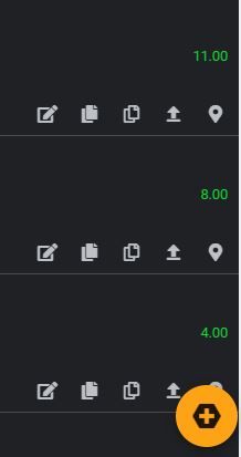

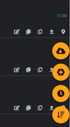

Pile of overlay actions
Although they are very useful but many times they block other useful info on small mobile phone’s screens. I don’t know if there is an option to contract(into one icon)/expand them with tapping.

No thats not really an option. But you could show or hide them based on some condition. You could also try using them either inline or promenently
Those are for different purposes. Many mobile apps have this feature (to hide/show overlay action icons by users).
AppSheet does not.
You can have different buttons showing depending on who is using the App by using the USEREMAIL() function
That’s not applicable to my requirement & situation.

Okay I think that a special table or column may be required to save the hide/show state of all related actions.
Thank you.
One additional column and two actions.
  1. Add one Yes/No column called say [Display Overlay]
  2. Add two overlay actions called say “Show Overlay” and “Hide Overlay” of type “Set the values of some columns in this row” with [Display Overlay]=TRUE for one and [Display Overlay]=FALSE Condition for these actions is reverse, [Display Overlay]=FALSE and [Display Overlay]=TRUE so they show alternatively.
  3. For all other overlay actions have the additional condition as [Display Overlay]=TRUE with other conditions if any.
The drawback of this approach is that it increases the sync queue. It may affect user experience if the toggle action is tap/click many times.
