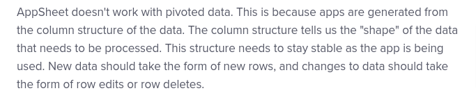

From the article you referenced:
I get a little tricky to show my pivot table in appsheet and i can export csv file that contain like the pivot table.
I make a sheet that reference to the pivot table sheet.
