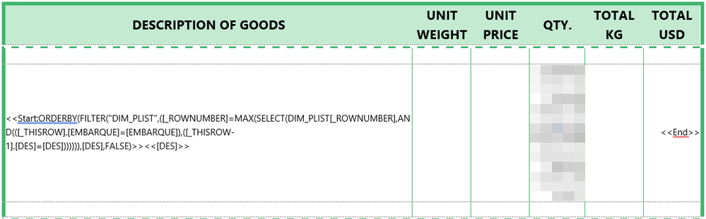

Here are the screenshots:
I’m sorry I have to blurr some of the info but it’s from my client. The important thing is that it summarizes the data to 4 unique [DES] as you can see, but I need to find a way to do it inside AppSheet to be able to add manual info (UNIT PRICE) and then pass that to the template.
As @MultiTech_Visions said, I think I should place those 4 summary rows inside an actual table but I have no idea on how to make that happen, how to create those 4 records at once with the click of a button (ACTION) as children from the table where I’m triggering the bot.
