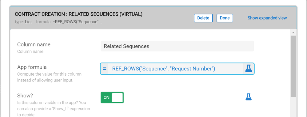

I’m trying to prepopulate a virtual column with the type of List which is referenced to another table containing the list of records.
Is there a way I can do this?
Note that as a reference list, the App Formula already has REF_ROWS expression.
How can I set the pre-population / initial value for the column I am working on?

This is my table 1: Contract Creation with a virtual column.
This is my table 2: in which the first table is referring to.

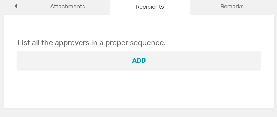

I am trying to prepopulate the inline form of sequence (table 2) in this form:
So far what I can do is having an Initial value when you click ADD.
What I would like to happen is to prepopulate this inline form with values when the form loads (without clicking the ADD button).
@aldjan_isg
What you are using is a reverse reference (a ref with isPartOf property set to ON) and unfortunately you can’t do that
@LeventK is there any workaround that you might suggest?
@aldjan_isg
If the list you want to display in that inline is fixed, rather than REF_ROWS, you can use the SELECT formula to retrieve that data.
