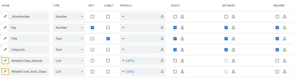

Hi All,
Is it possible to prevent the creation of related list virtual fields?
They still get generated even if I deleted them. I donโ€™t mind hiding them but I see on the Performance Monitoring that it consumes sync time.

I think I found a solution, I simply overwrite the formula with
LIST()
The Performance Analyzer shows time gain for the table.
