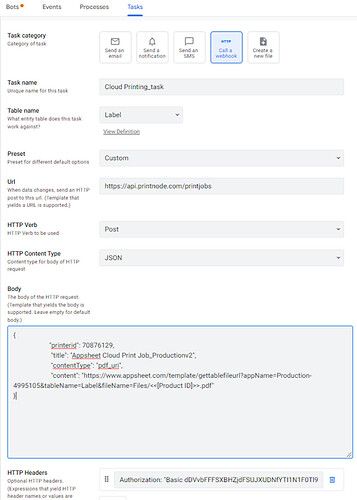

I would like to do printing from my Appsheet and found printnode solution from DIY Replacement for Google Cloud Print (Shutting Down Today) - #63 by sfd_pl.
But Iโ€™m hit with error 400. See below.
My end goal is to print barcode from my GoDex RT700iW label printer when i fire an instruction.

This will not work if used outside of AppSheet:
<<[Product ID]>> is a template instruction interpreted by AppSheet. Outside of AppSheet, it has no special meaning and will not be handled as AppSheet would. You cannot test the web hook using your testing tool with the template instruction.

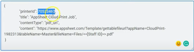

Hi Steve,
I followed the @aijac1314 video. Below is the snapshot from his video(7:00)

This URL will never work if used outside of AppSheet. Even within AppSheet, the URL is only usable in very select places. Both of you have incorrect expectations.
Ok Steve, will manage my expectation

My monitor page(Process> Steps> Detail)
My URL - https://www.appsheet.com/template/gettablefileurl?appName=Production-4995105&tableName=Label&fileNam...

This error indicates printnode.com is refusing your connection. Youโ€™ll need to get help from printnode.com for that.
Ok will check with printnode on this error
