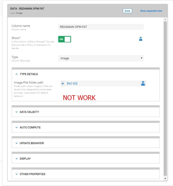

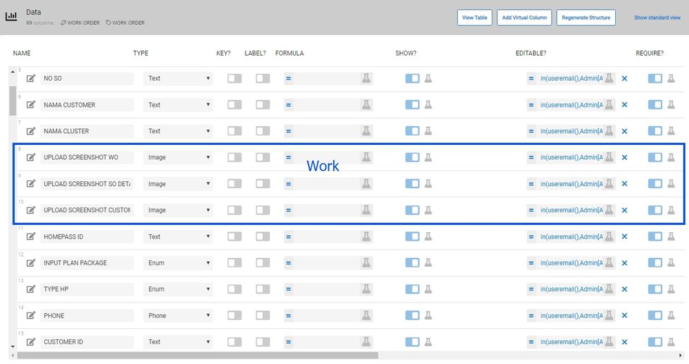

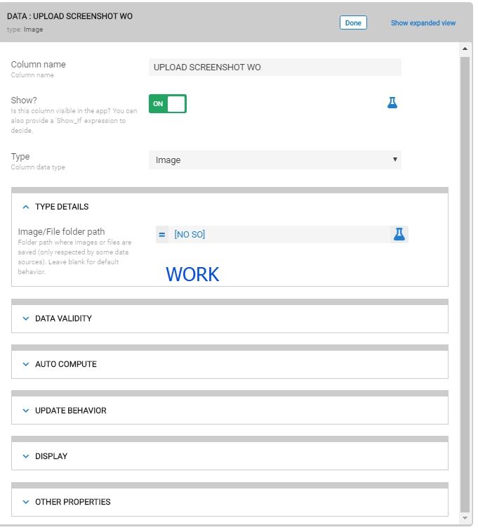

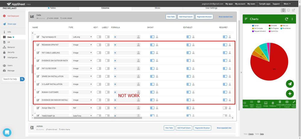

Hi @Gil,
Could you help me to check this problem.
i try to change a folder path to stored the image. but only work for 3 column. other column still on the old path (standard path from appsheet โ€œData_Images/โ€.
Iโ€™m pretty sure that i already change all the path to the new one.even i use โ€œCopy pasteโ€ the path from the column that working. but still nothing happened. would you mind to check this?
Thanks in advance
WORK Path that created โ€œSO-0047702/INST0074283.UPLOAD SCREENSHOT WO.030330.jpgโ€
NOT WORK Path that created โ€œData_Images/INST0074283.REDAMAN OPM FAT.080618.28_%2Fstorage%2Femulated%2F0%2FWhatsApp%2FMedia%2FWhatsApp%20Images%2FIMG-20191129-WA0064.jpgโ€
