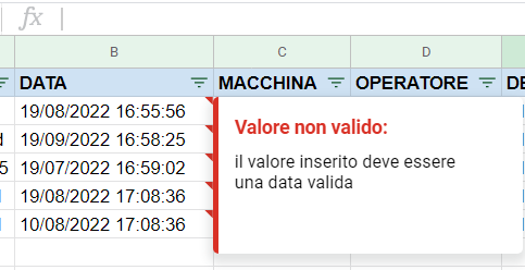

Hi everyone, unfortunately I am not able to agree Google sheets with Appsheet regarding the dates in extended format in order to then be able to correctly filter the dates on the sheet A-Z or Z-A, let me explain.

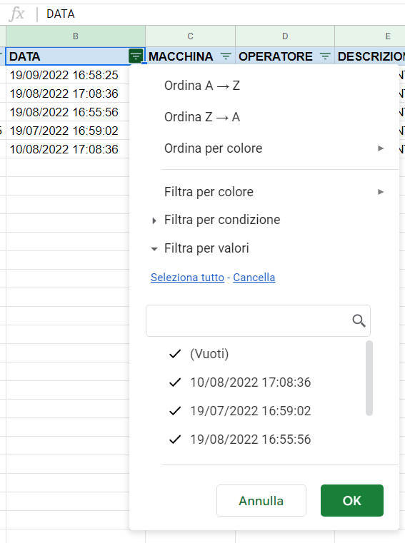

Both Google Sheets and Appsheet are localized in Italian but as you can see from the last image, the filter function cannot correctly sort the dates from the most recent to the oldest.

Data validation: invalid valueData validation: invalid value
Wrong dates sortWrong dates sort
Unfortunately Appsheet localized in Italian, writes the date as DD/MM/YYYY HH: MM: SS
Google Sheets localized in Italian instead wants the dates as DD/MM/YYYY HH.MM.SS
The data validation (Check: Data = "is a valid date") gives me "wrong value" and consequently the Z-A or A-Z filter does not work, if instead I manually write the date in the format DD/MM/YYYY HH.MM.SS, the validation data is successful and the filter works correctly.
I found a trick, set the Google sheet in English (united kingdom) but I'd like to solve with the Italian localization (Italy)

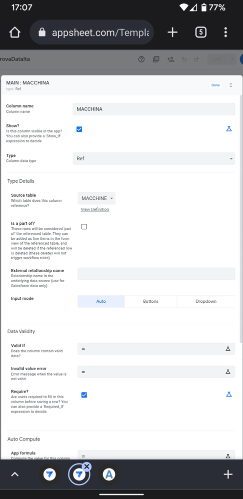

Share the column config from AppSheet editor
Screenshot 1Screenshot 1
Screenshot 2Screenshot 2
Screenshot 3Screenshot 3
Thanks for your help @SkrOYC , I hope these smartphone screenshots satisfy you, I'm on vacation and I don't have a pc at the moment.

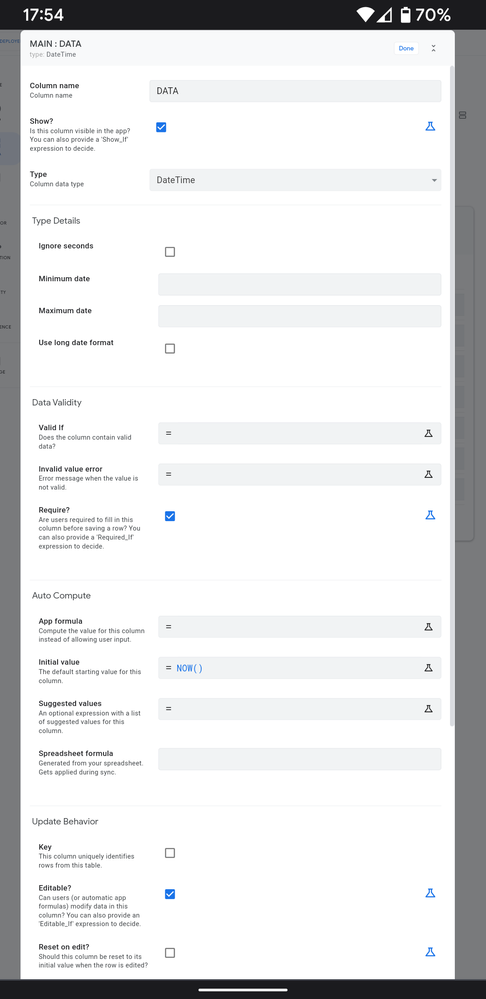

My only advice would be this:
If it works and looks accurate inside AppSheet, it's ok, because you should not work with the data directly from the GSheet since it breaks the purpose of having an AppSheet app.
In other words, configure the GSheet on a way that's compatible with your expected behaviour for AppSheet. In this case, you already found that having UK locale is enough
Actually this was the screenshot I wanted to send you, I had the wrong column
Column settings for datesColumn settings for dates
