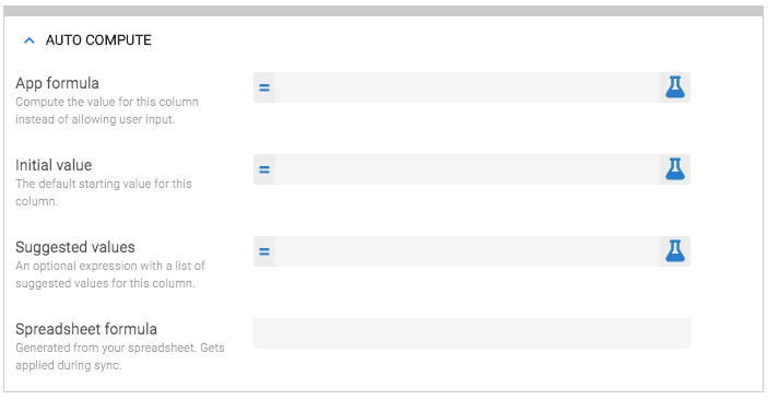

I wonder, did you have any formulas in the Google sheet that could have been introduced to the column? If you did, AppSheet might be trying to apply the formula still and you would want to remove it. See the image below for the Spreadsheet Formula property location.

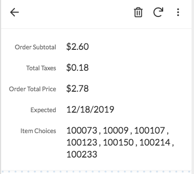

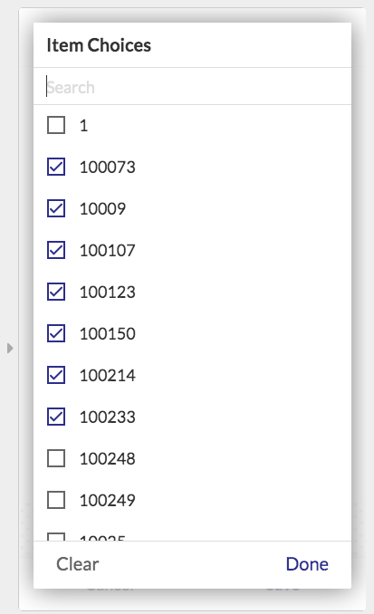

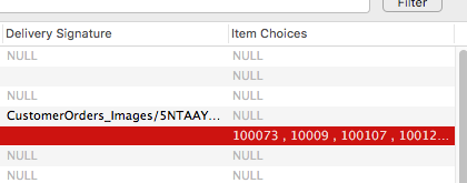

So, I just played with this, I actually did not have an EnumList column in my app so I added one. I called it Item Choices and defined it as varchar (150). I was able to add a record, select multiple items from the list, save it, Edit it, changed it from 3 to 7 items. I also tried closing the app and re-opening it after both Saves. I am not seeing an issue at all.
Item Choices in App after 2nd Save
Item Choices in MySQL db after 2nd SAVE - the … means more items
Dropdown EnumList showing chosen items

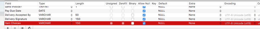

What is your data type for this column in MySQL?
I didn’t assign a list separator so it just uses the default which is comma. Also note that my Base type is “Text”. What is yours?
Datatype is defined as VARCHAR(150)
Column definition - note the Base Type
SQL column definition

Values in SQL Database
