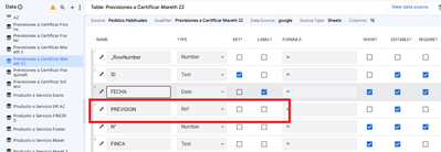

Buenas, estoy teniendo un problema al regenerar la estructura de una tabla. Tengo que agregar la columna "Autorización" pero appsheet no lo esta agregando a la app cuando regenero la estructura. Una de las columnas tiene una formula en la planilla, ¿será por eso?
Como puedo solucionarlo?

Did you use this button for the current table in the Data Pane?
Make sure the correct table is being selected 🙂
Yes, I have used that button to restructure the correct table, but it's not updating in the app. I tried deleting a column and added the "AUTORIZACION" one, but to my surprise, the previous column I deleted, "PREVISION", still appears in the application
Aurelien
Google Developer Expert
Very weird. The same happens when regenerating after 1 minute?
Yes, the same thing always happens, although from what I've been testing, it seems that the issue is with the Google spreadsheet. I created a new spreadsheet and added it to the app, and it picked up all the columns.

OK, looks like a bug then.
You may want to file a ticket for it.
