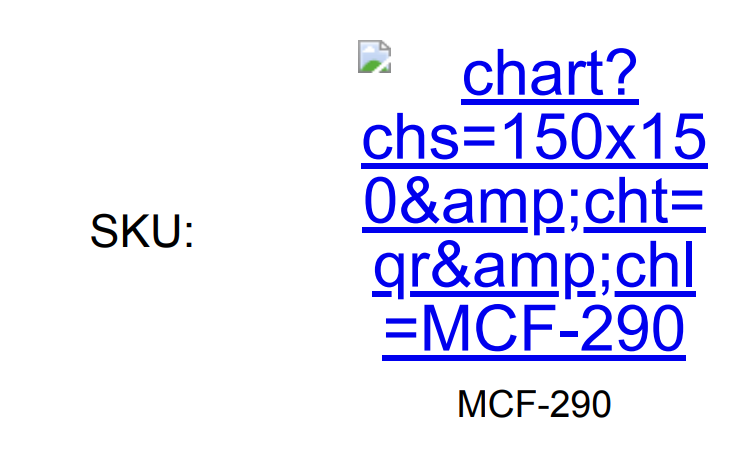

I have a bot that generates PDFs with QR codes through the Google URL that I believe I found on this forum. I have virtual columns with type of image, using a concatenation of the url and the data I want to pass through as the QR code. Some time yesterday, it stopped working for one of the 3 QR codes we generate, but today it is no longer working for all three. I ran the formula test, found one of the URLs that is being generated, went to it in Chrome manually and it appears fine. Just doesn't appear in the PDF template. Please see screenshots attached. Anyone have any ideas what is going on?Screenshot 2024-01-04 at 9.50.34โ€ฏAM.pngScreenshot 2024-01-04 at 9.50.39โ€ฏAM.pngScreenshot 2024-01-04 at 9.51.24โ€ฏAM.png

Does the app show the image fine?
No, the app was not showing the QR code images either.
I would propose to contact support so devs could debug the reason.
