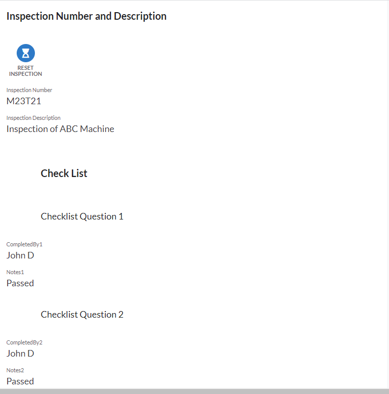

  1. Add a number type column to the table called say [Reset Inspection], initial value zero.
  2. In each of “Completed by” and “Notes” columns’ “Reset On Edit” setting, add an expression
[_THISROW_BEFORE].[Reset Inspection]<>[_THISROW_AFTER].[Reset Inspection]
  1. Add an action called say “Reset Inspection” of type “Set the values of some columns in this row”
Set [Reset Inspection] to [Reset Inspection]+1 in this action. Add a suitable confirmation message.
Whenever the user taps on this action, all the “Completed by” and “Notes” columns will be reset to their initial value.

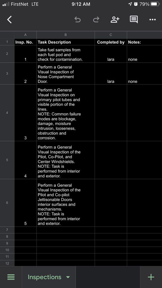

Thanks for the help. It worked up to a certain level. I am not expert on computers and that’s why it took me some time to figure it out. since my App consist of 199 inspections, once I’m ready to reset my app back to inspection description, I have to reset one by one instead of one click of a button and all inspections would reset at once. I tried to send a picture (actually is a PDF sheet) of of my project but it does not allowed me to share. is there something else I could try to reset all at the same time?

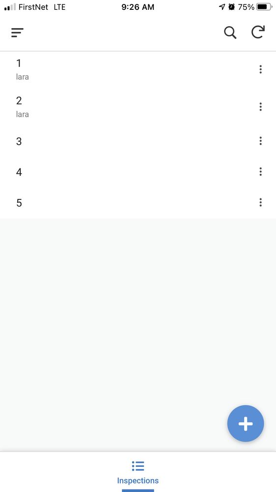

No sir. It’s on one record only. (I’m sending this pictures, I’m not sure if they can be seen)
Here’s the second picture.
Thank you. Could you update how many ctotal olumns your inspections table has? And what type of views you have shared. The second picture appears to be of detail view with a single question in the record.
Yes sir. I have 5 columns. The last one is the “reset inspection” on this template I have just 5 questions instead of 199 to test the app and work all the glitches. Here’s a picture of what questions look like( it only shows numbers for now until the final product)
I think what you call as columns are actually rows.
In that case you could use reference actions to reset those multiple records. However using reference actions to delete as many as 199 records may not be a good idea.
