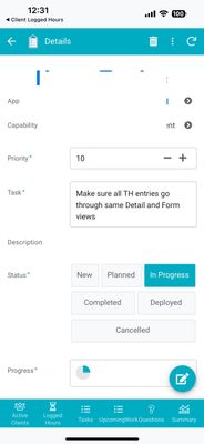

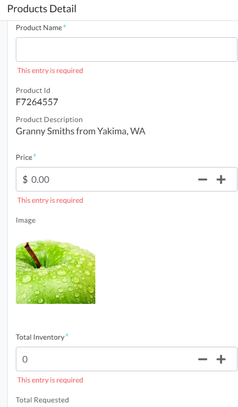

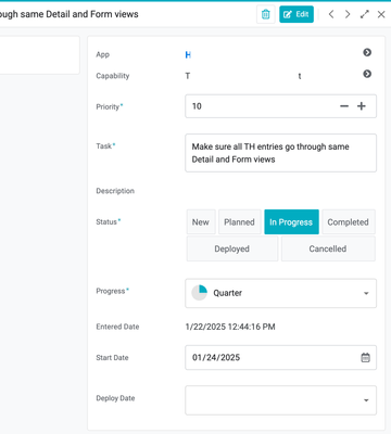

Regardless, I am not seeing an issue.  Below are screenshots of an app I use daily that has Desktop Mode on.  I views my Detail View with Quick Edit fields and all expected required fields are marked with "*" as expected.
Do you you have expressions determining requirement?  Maybe they are not providing the response you expect??
Detail View with Quick Edits on Mobile
Detail View with Quick Edits in Desktop Mode
